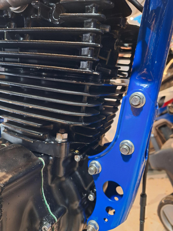

I wasn't happy with the pock marked lower engine mount so I sourced another and had it coated. It didn't have any rust at all.
The observant will see the issue with the magnesium cases originally fitted to the 1VJ....corrosion.
But maybe not the titanium barrel nut
It's busy time at work, holidays etc.
So here's a catch up post, I haven't been totally inactive.

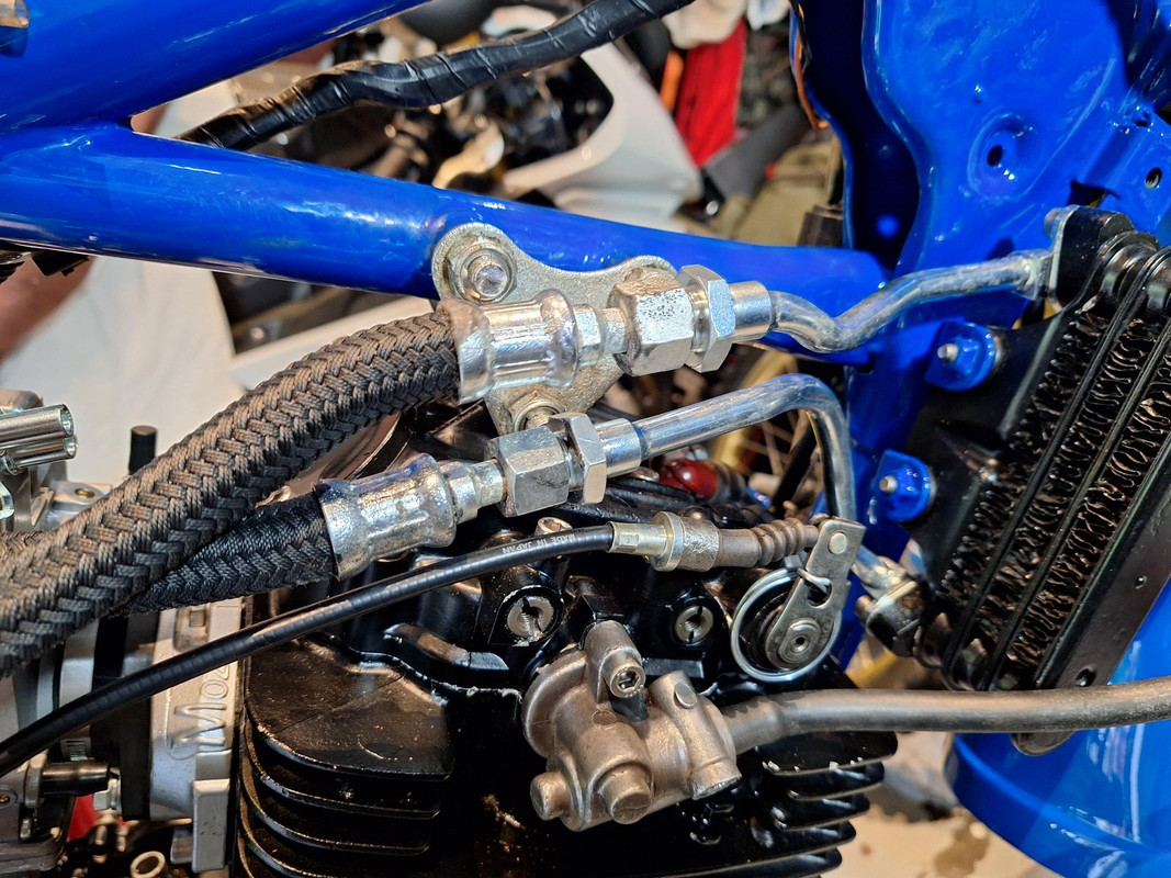

Got the oil system up and together, apart from the oil strainer. I may have to rob one from the white 1VJ or 3D print one, maybe some sort of washer as packing.
I had the pipes replated but I'm gathering together another set to send to the XT500 guy who refinishes them with new oil lines.

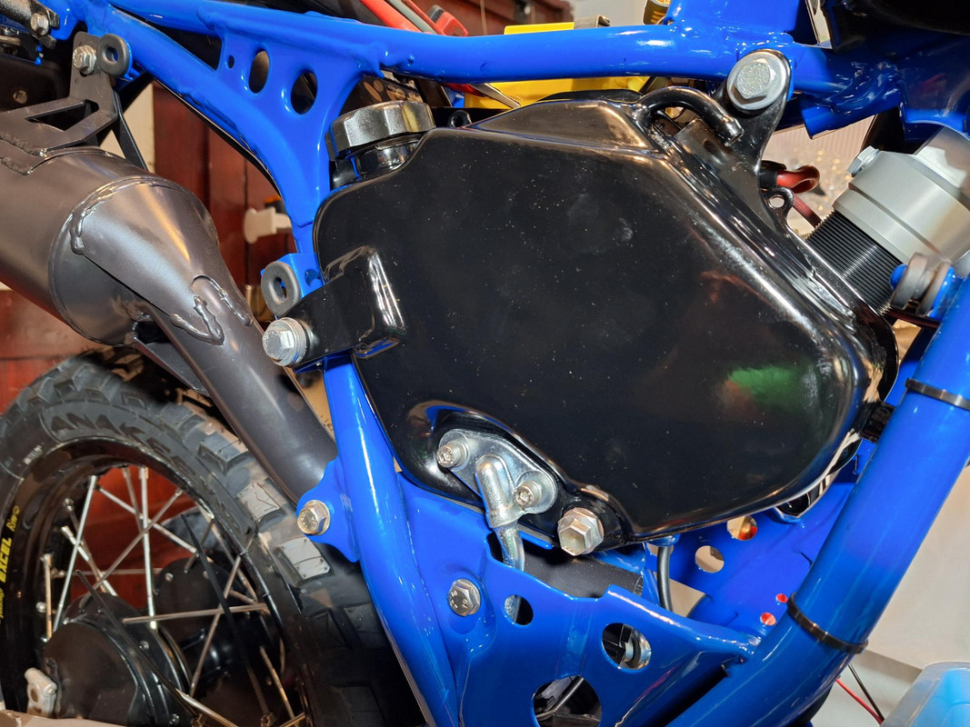

Had the oil tank powder coated in correct gloss, it was full of rubbish when I cleaned it before sending, now mounted.
Brand new genuine Yamaha decompressor and rev counter cables.
