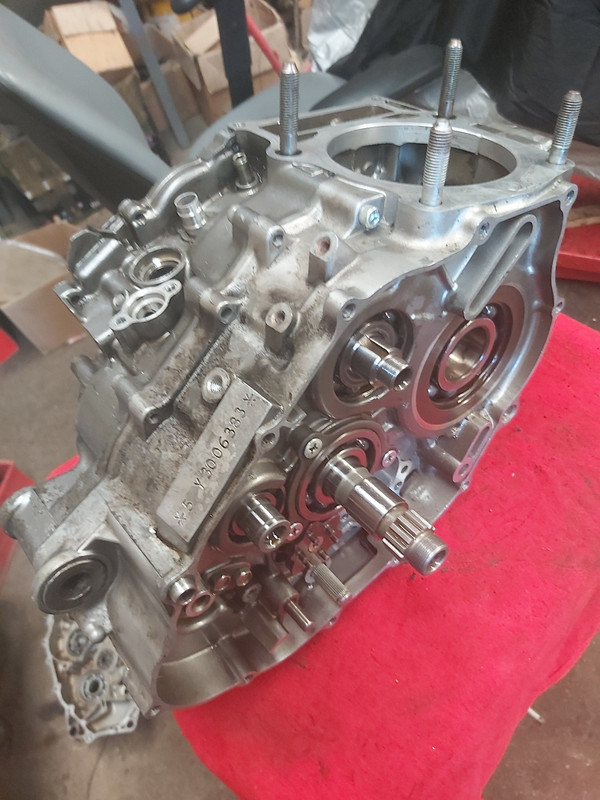

Got my 1VJ cases in the mail recently and finally had the time to set about cleaning them up and knocking in new bearings. I think I finally understand after all these years how to do this sort of thing so I'm hoping this rebuild goes smoother than previous years. Even got to use a famous Tenere forum specialty tool. Which one of you made this crankshaft protector again?
I hope to drop in the the transmission and crank and close up the halves by the weekend. Then, as they say, you merely draw the rest of the fucking owl

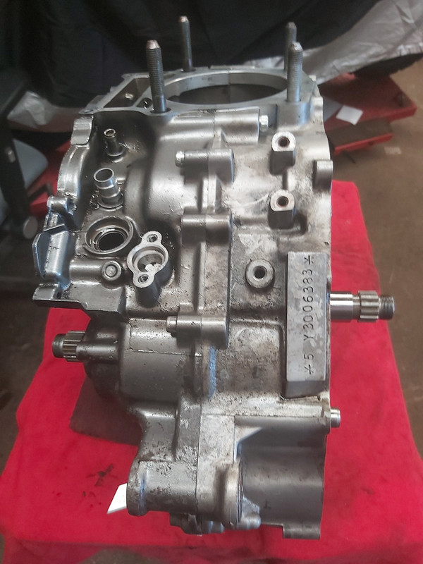

Got the bottom end tightened up and the right side reassembled. Gears and crank move smoothly and shifting is working as normal. :funkynanna:

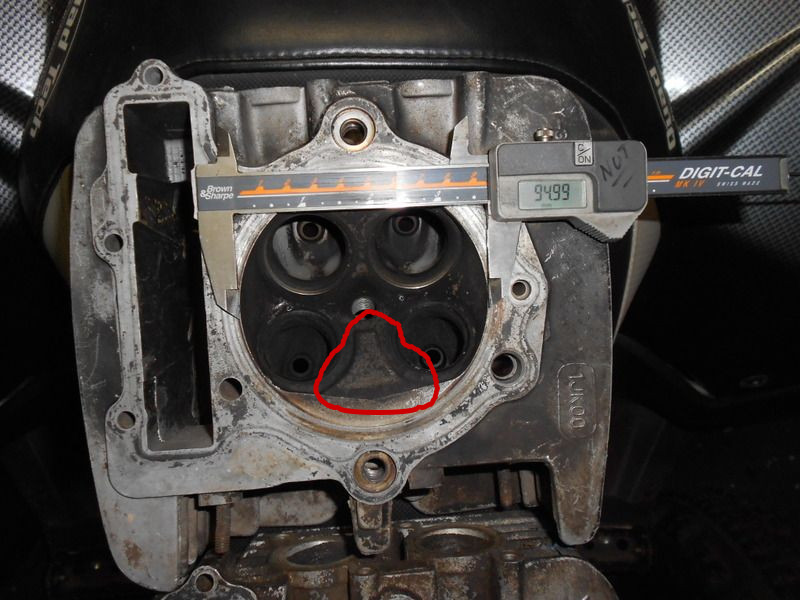

Now I'm moving up in the world and looking at the top end, but I have acquired quite a few sets of matching and mismatching cylinders, heads, pistons and valve covers so I'm trying to figure out which is which.
Can anyone shed some light on the difference between a 1JK head and a 2KF head? Both bolt patterns matches the 3AJ cylinder so that's good, but I cannot remember what the difference between the two models is. I can see a different casting mold was used, or the machining process was different, but the head gasket used is the same, I think.

Not sure where the 1JK code originates from Scottie? or even if its from a XT? the 2KF is easy its in the model codes section on here & is XT600 1987 2KF USA,CAN your fellow American (xtrider) was talking about this back in 2014 HERE..

The 1JK code means it's from a SRX600. Did not now they had different heads, but perhaps they are the same as later XT600's.
Re: Scott's 3AJ restore
Bowler wrote: Tue Dec 01, 2020 7:24 am The 1JK code means it's from a SRX600. Did not now they had different heads, but perhaps they are the same as later XT600's.
Did you notice the extra bit of meat on xtriders 1JK head that Scotties head doesn't have. :sherlock:
More compression?

Mezo wrote: Tue Dec 01, 2020 9:11 am
More compression?
That's strange! Perhaps they switched casting molds halfway in the model? Still would love to have a SRX600 (too bad they are kick only, otherwise I could have gotten my girlfriend one).
