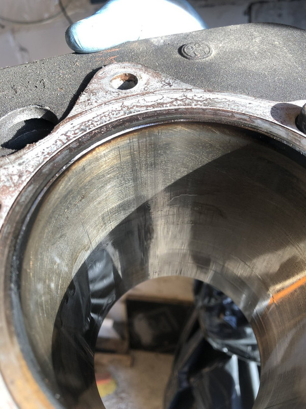

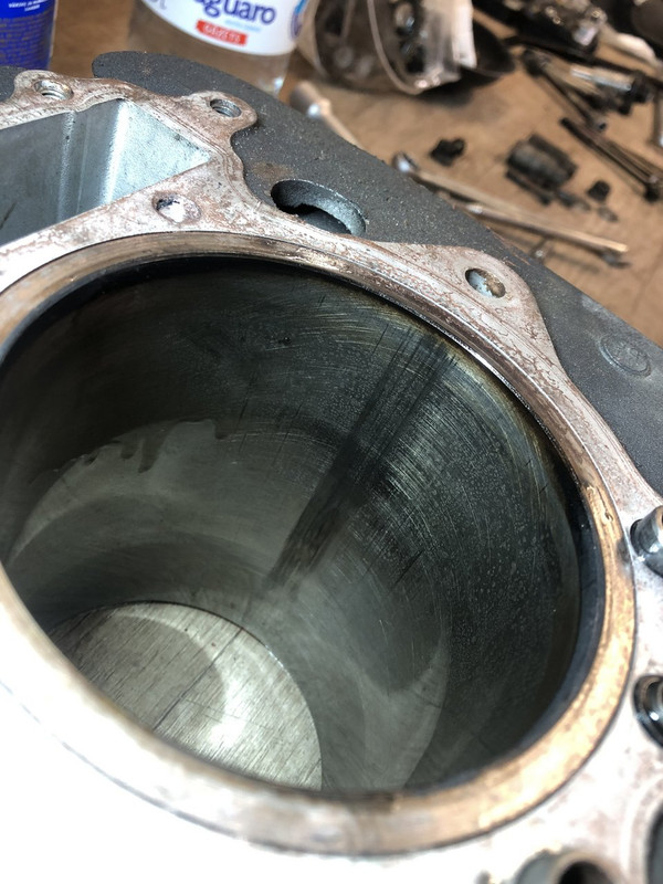

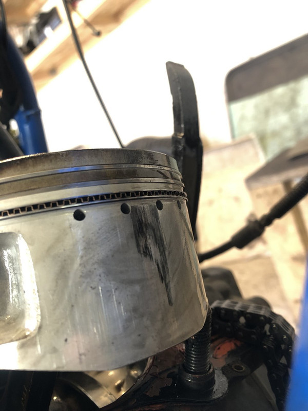

So, the riding season has passed with almost no riding done with the poor Tenere, starting to feel like the engine has been cursed.
The smoking got gradually worse and I decided to take the head off. Immediately noticed that the cylinder and piston were excessively worn, considering the fresh hone and the fact that I have ridden around 500KM after putting it all together. Also the Piston wrist pin and small were married together so I needed to apply hammer to remove the pin.
For me the problem started (atleast visually) at a random startup when I got shitloads of smoke and after that gradually going worse. Definitely piston/top end has lacked lubrication at some point. So even when changing all damaged components I cannot be 100% sure what the root cause of this was. These was already minor wear on the small end before, but asked around and it was said to be OK(picture at 2nd page of this thread)
Alltogether I determined that I will now need to:
Replace piston
Rebore cylinder to next size
Change Conrod
Remove broken bolt from Cylinder hear
Not sure if I will manage to have the engine back together this year, but fingers crossed.

A stuck connecting rod or out of round cylinder sleeve would be some things to consider as the culprit. Looks like you got front and back scoring. Does the con rod look like it got too hot? Kinda blueish? Or was it a tough fit to begin with? What about the cylinder? Did you press in a new sleeve or bore/hone an old one? Can you test the cylinder for roundness now that it’s apart?j0epere wrote: Wed Jan 03, 2024 1:08 pm So, the riding season has passed with almost no riding done with the poor Tenere, starting to feel like the engine has been cursed.
Replace piston
Change Conrod
