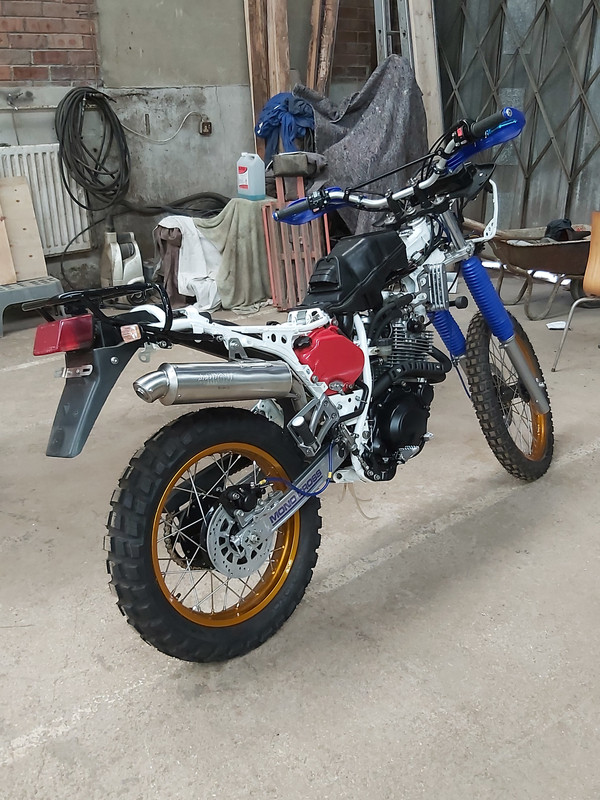

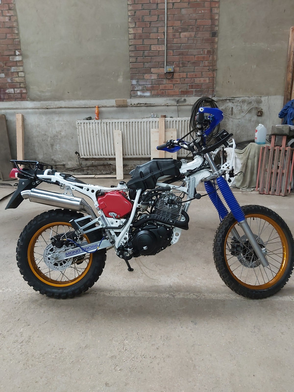

Back in December 2014 when I picked up the bodywork for my 1VJ & Tenere 4 from the guy who painted them (in Wales)... I dropped off a full set of bodywork for Tenere 5 (TT Tenere) & mistakenly told the guy there was no rush :rolleyes: as I had Ten 4 and the 1 VJ to finish... so a good while later when Tenere 5 was done the bodywork wasn't finished... actually wasn't started yet :foot_tap: so I nicked the bodywork off Ten 1 and used that... I then had a set of bodywork painted locally to fit back on Ten 1...
This one
Wasn't really a problem as I knew I could use the bodywork in Wales for Tenere 6... but, it's still not fucking finished, or started... lots of reasons why, redundancies, garages falling down, firms going bust and latterly covid 19 and lockdown...
Had lots of discussions with the guy who's doing it, and hopefully it'll be started next week... if not I'm gonna have to go get it and get someone else to do it... it's been a real pain in the arse....
It's been finished for 2 fucking years almost....
Cleaned it today
So that's where I'm at with Tenere 6, just in case anyone is wondering...
