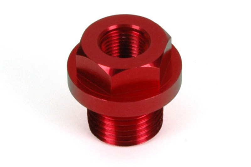

I had an oil tank (from a 34L) which somebody had fitted a temperature sender on, they had drilled a hold & brazed a nut the same size as the sender thread, the oil tank is the most suitable place to measure oil temperature as that is where the oil is held (dry sump)
From reading TrailTech now do oil sensor (they never used to) it was water temp & then a stupid sensor that wedged between the cooling fins on the cylinder head & that only really measured the outside temperature of your engine not the inside temperature of your oil.
Now they seem to sell a oil senders & the adaptor bung M12x1.5 which you could braze on to the oil tank (importantly at the bottom).
