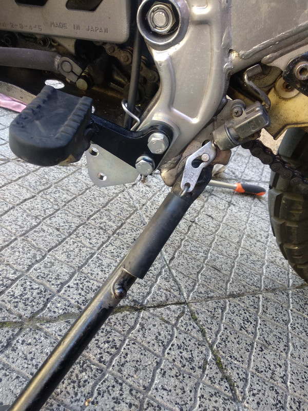

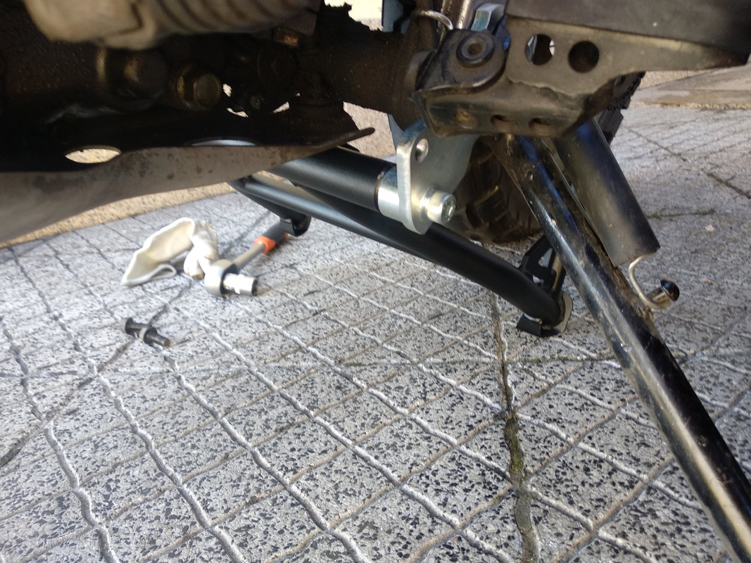

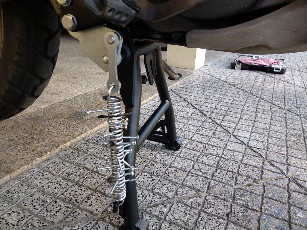

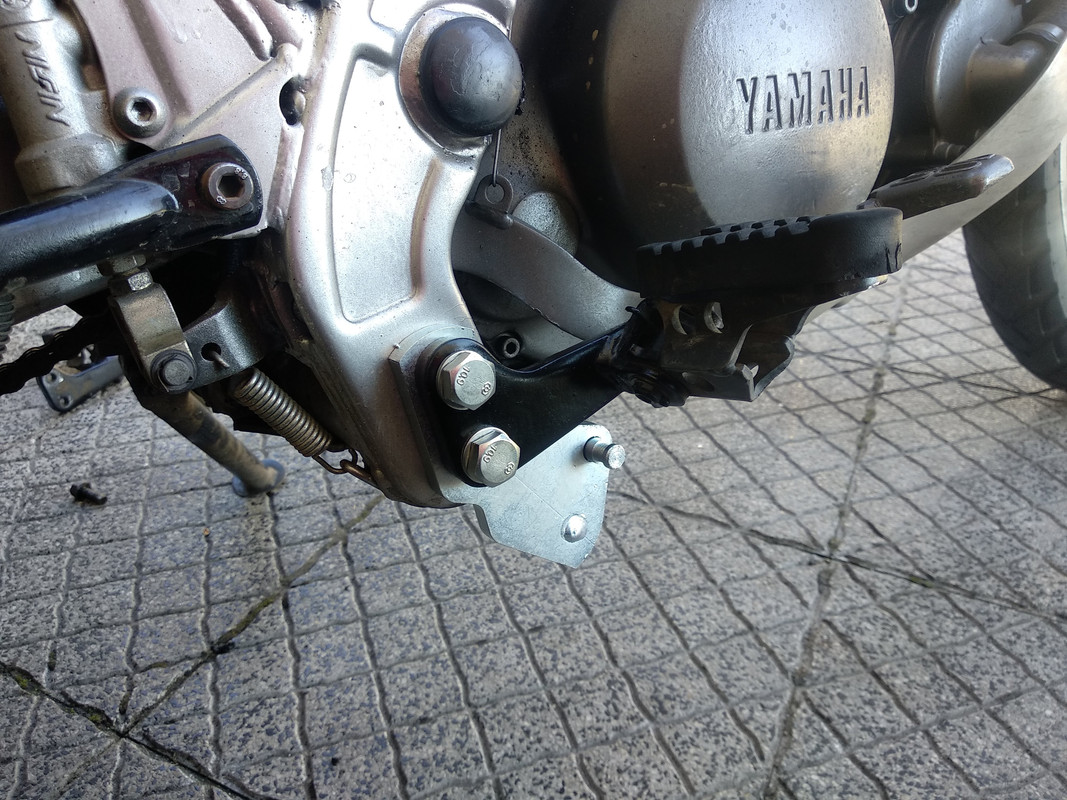

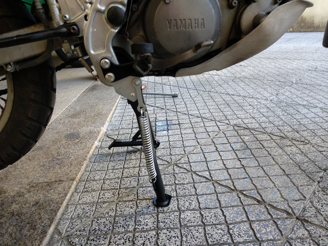

Hi!
I bought this center stand from HeavyDuties in Romania (https://heavyduties.ro/product/yamaha-x ... ter-stand/)
1 - Remove the footpegs
2 - Bolt right support
3 - Bolt left Support
4 - Slide center Stand
5 - Tighten everything up an ensure good movement
6- Stretch spring
7 - Remove spacers
8 - DONE!

Love the Spring stretching technique.
Listed as xtz660 but fits 600 too.

Ploddit wrote: Mon Jan 18, 2021 6:58 pm Love the Spring stretching technique.
Learned that one years ago. And it's a good use for the "random miscellaneous stuff" box
