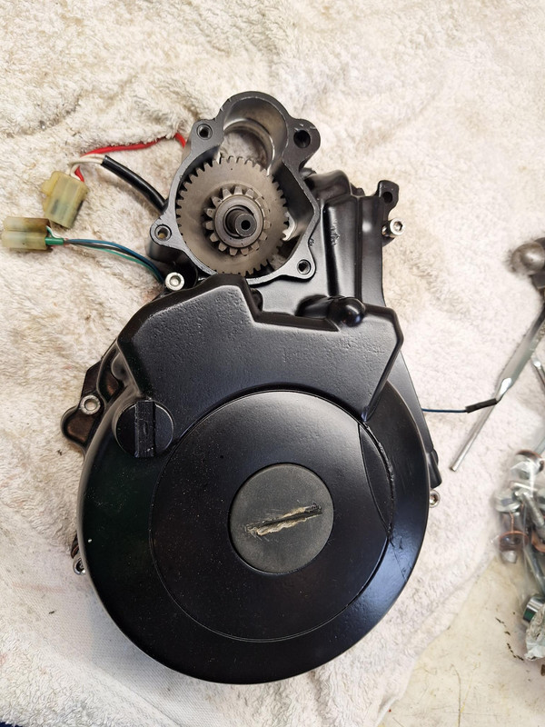

Are you sure you have correct stator and CDI for the 1VJ ?
The 1VJ stator looks like this:
And the IVJ case should look like this:
img photo hosting
If you engine case looks like this it's a later 3TB type with TCI:
That's the later different type of stator and different TCI or digital CDI as it's known.
Motorang gives a thorough explanation if you use the search bar at the top for TCI.
img photo hostingIf you engine case looks like this it's a later 3TB type with TCI:
