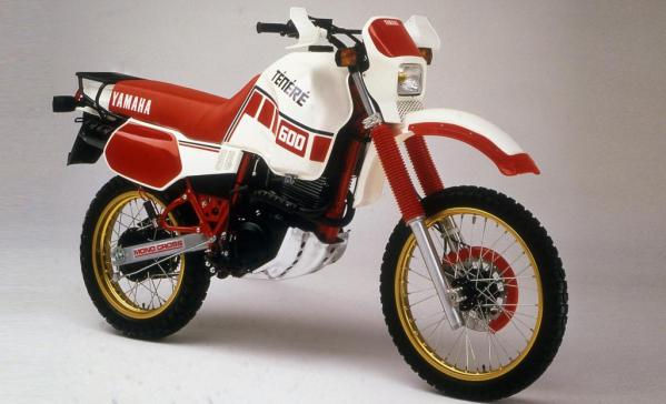

That huge fiberglass fairing was always a heavy nuisance!
The small plastic fairing of the 43F is very similar to the stock 1VJ fairing. It's not perfect but hey. :tenere:
Stock 1VJ
Stock 43F

I'm a patient man... Someday I will track down the real deal even if the bike only wears it occasionally.
