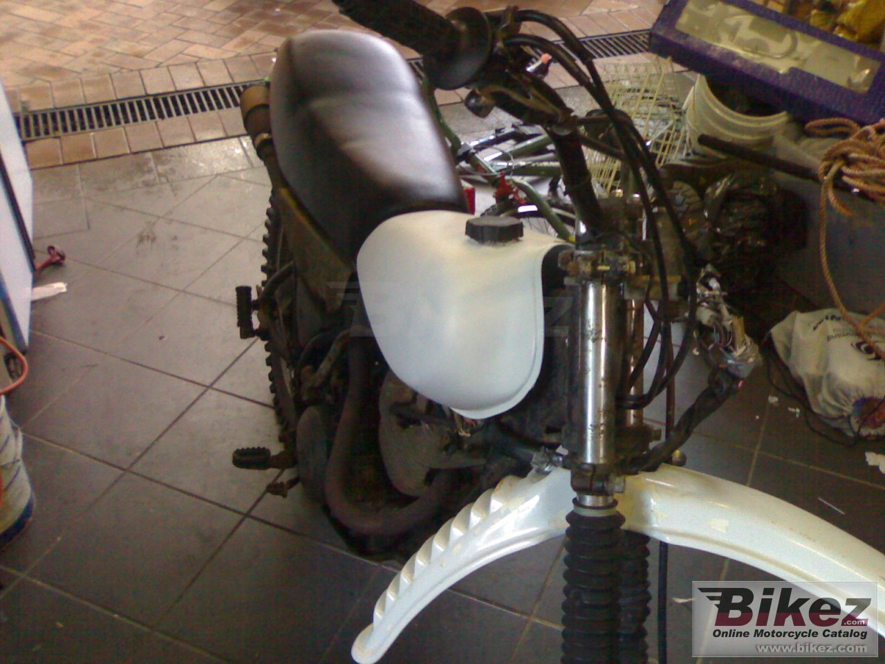

Are the "Highway pegs" factory or aftermarket?
It's seen some wheather that bike, nowt that a bit of tlc won't cure, it would be a great story.
