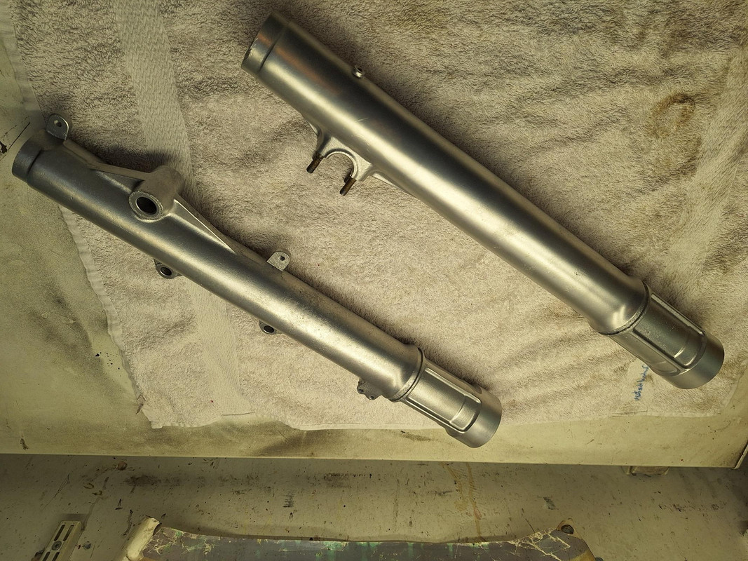

Dropped some parts for vapour blast:
These are the original forks which I'll build up as a spare set.

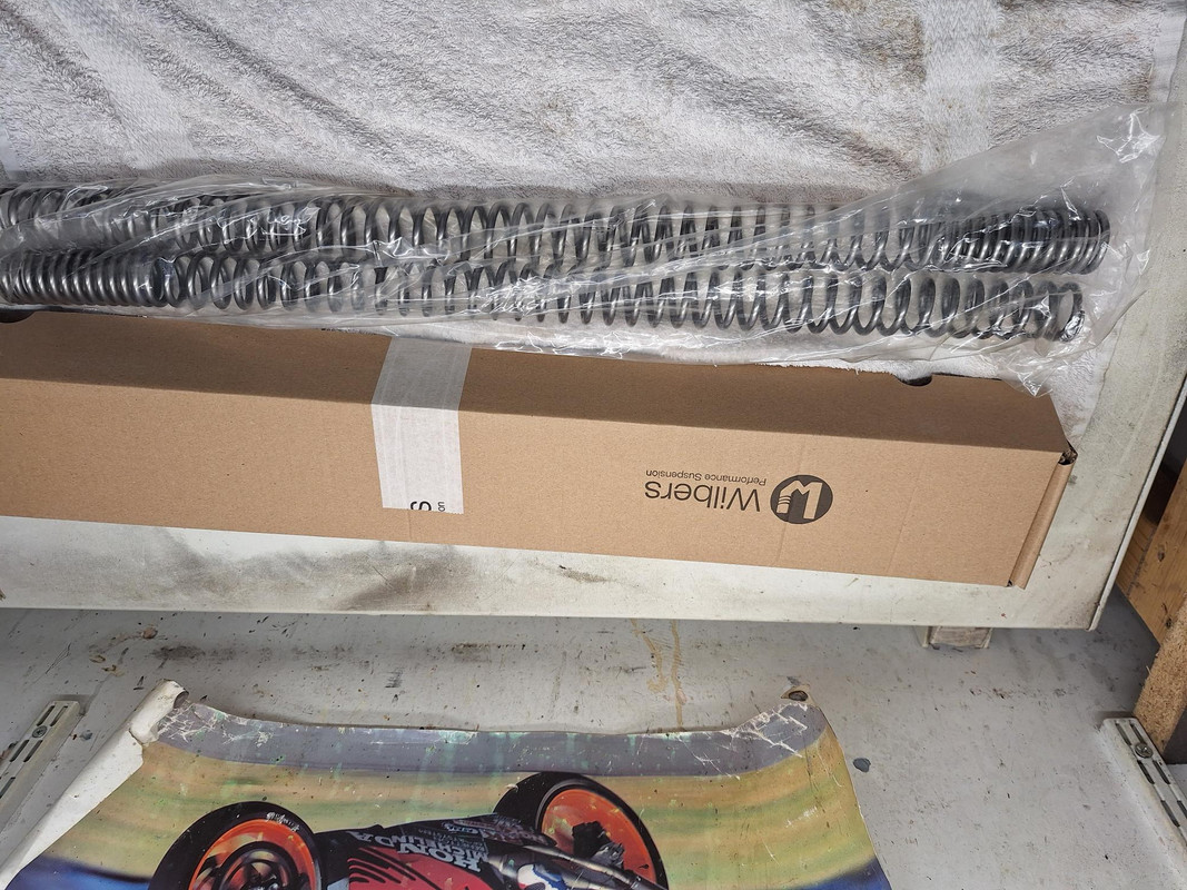

Got a delivery from Wilbers so these fork springs will improve the front end:

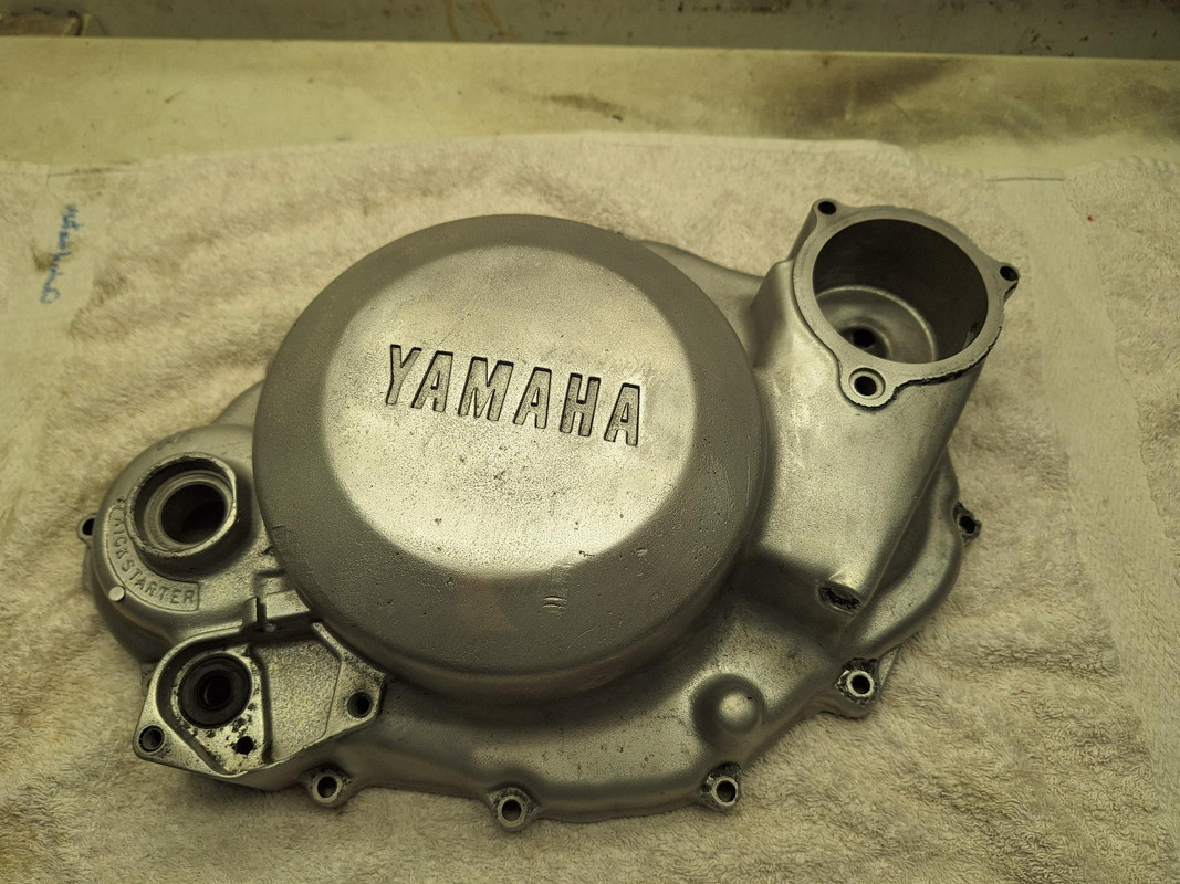

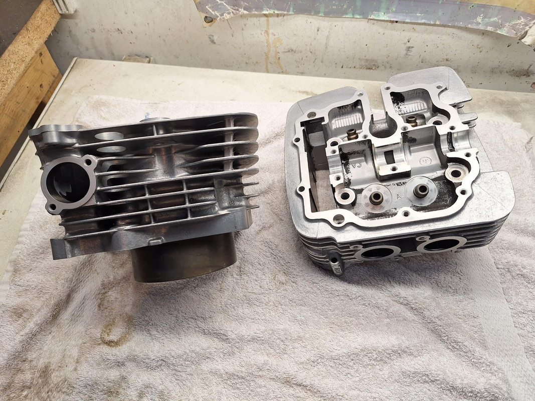

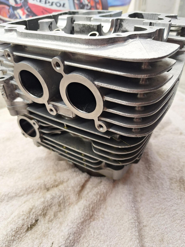

Then I've made a start on the engine, top end basically apart and been vapour blasted.
Dismantling can always be a bit fraught with damaged and seized fasteners.
Magnesium side cover:
Cylinder head and barrel.
I'll get it rebored at Grampian in the next few weeks and sprayed up, then I can rebuild the top end.

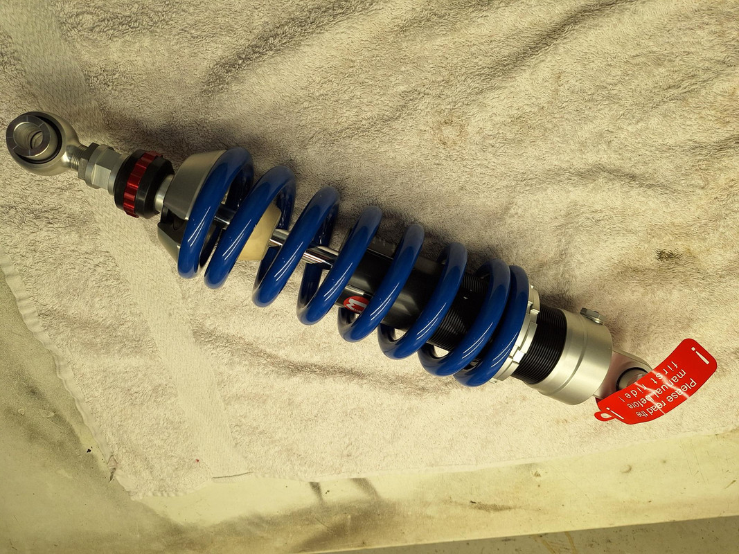

I don't know how I forgot to post this!
Adjustable this time so we can reduce the seat height for my vertically challenged brother :rofl:
The quality of finish on them is outstanding, all four of my Tenere's now have Wilbers in them.

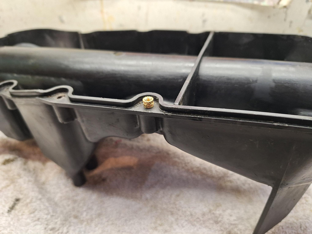

One of the things you'll always find when rebuilding a 1VJ is that some or all of the airbox screws will be threaded, so you can't actually get a good seal when clamping the airbox back together.
The reason for this is that the screws used by Yamaha are self tappers into a plastic airbox.
I'm looking at ways to improve this by putting a metal insert into the lower of the old airbox.
There's basically two ways of doing this.
Brass heat inserted - so you use a bit in a soldering iron to heat the threaded insert up, and basically melt it into the plastic.
Threaded insert - almost like a timesert or helicoil but for plastic.
I've got both coming and I'll have a play to see which works best.
Brass heat inserted:
You have to drill a hole to the size of the bottom of the insert.
Then I'll use a stainless M5 cross headed screw.

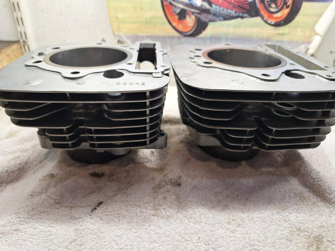

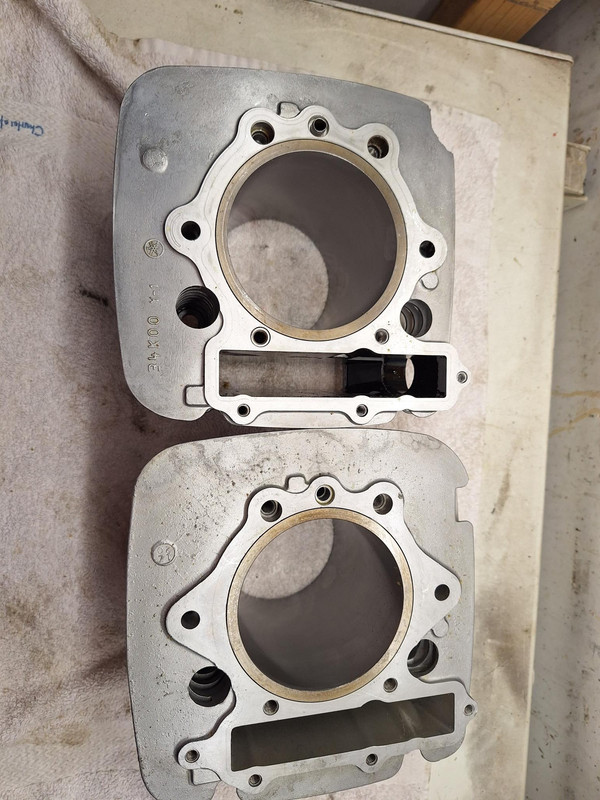

Took two barrels to Grampian in Liverpool for rebores this week.
A 1VJ and a later 3AJ, I'd never put the two barrels together before.
3AJ with much more cooling area side view:
Top view, the lower barrel is the 3AJ

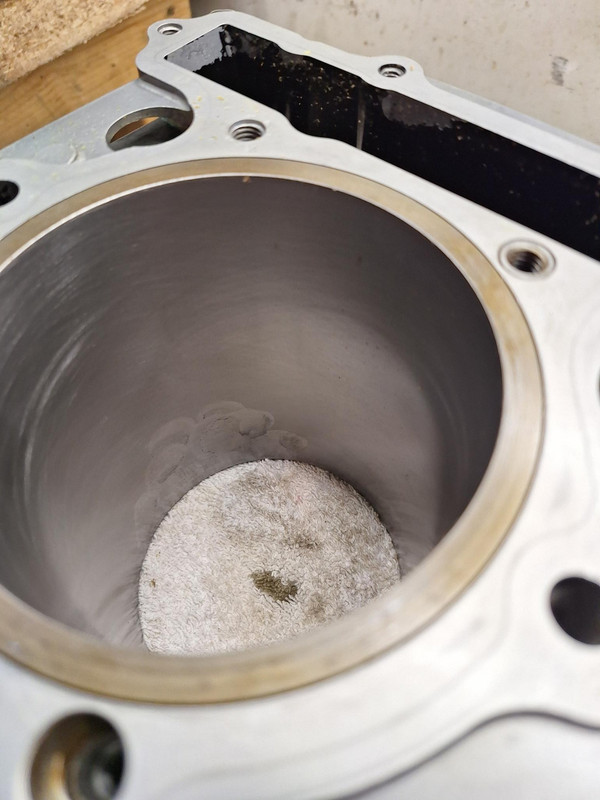

Rebore:
Barrel and head reunited:
I'll get them cleaned off to get all the honing dusk off them, then they can be resprayed and rebuilt.
