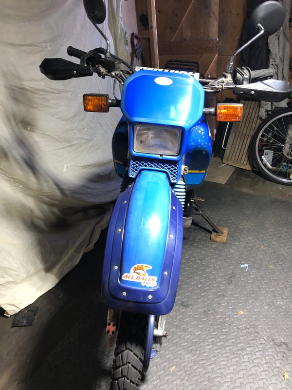

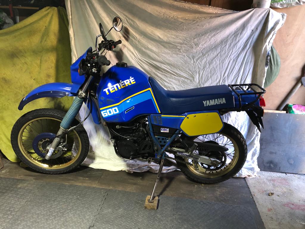

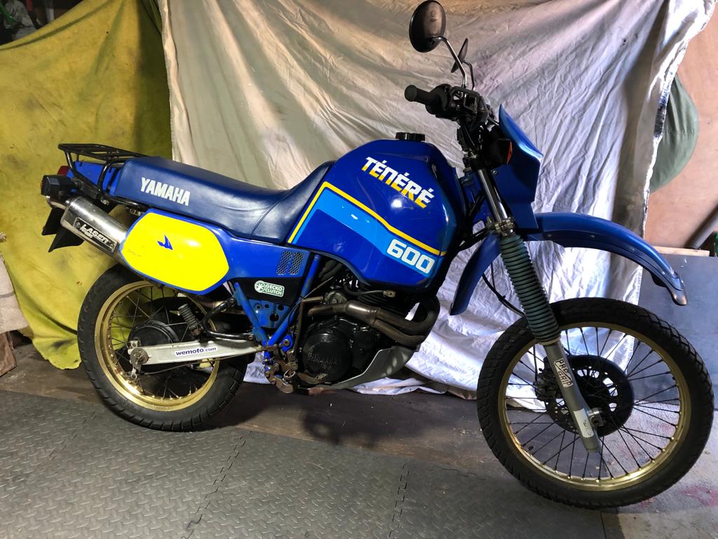

Some images of how it came to me.
[quoteImage][/quote]

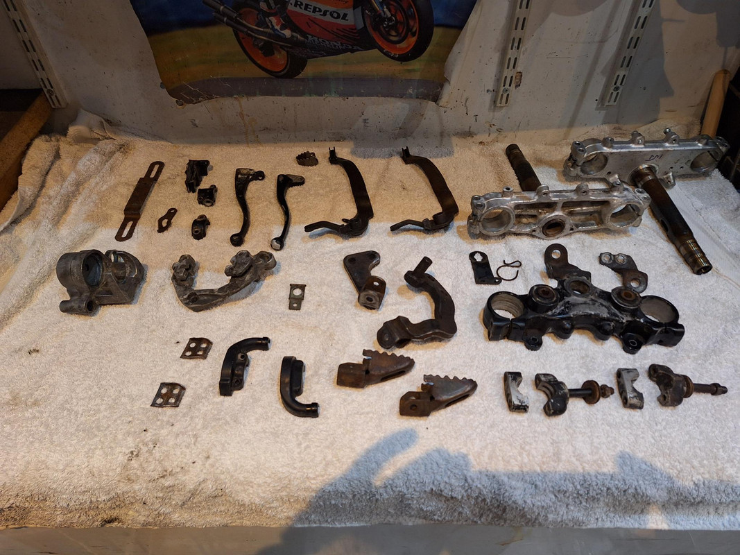

Drop powder coating for front end and any easily removed parts off. IN PROGRESS

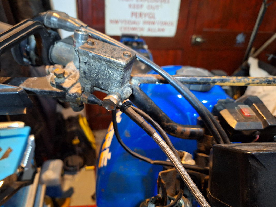

Rather manky front master cylinder

First batch of powder coating, heading for Camcoat.

Whats that switch thing on the handlebars between the clamps for? Some sort of 1980s aftermarket box of magic?
It's a horrible USB charger type thing with the ability to switch it on and off.

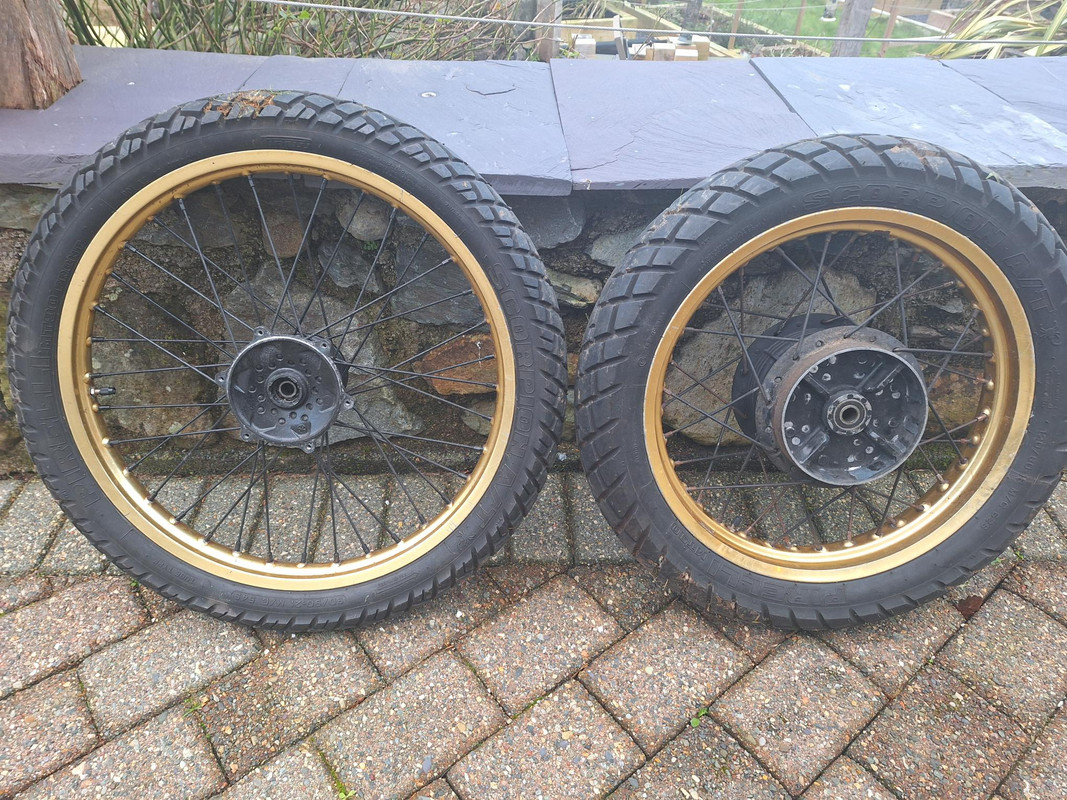

Here are the original wheels, these will get rebuilt with hopefully ceramic coated rims and hubs.
Got some very nice original wheels from the stores. These can stand in until the rebuilt wheels are back.

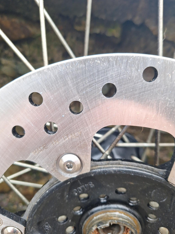

Fitted with a new Brembo disc, I don't use the nearly 40 year old originals. The brakes are marginal enough already.
If using the Brembo disc on the earlier type hubs the holes are 8mm so you either need to drill and re-tap the hub, or use a stepped bolt, these are titanium stepped bolts :drool:

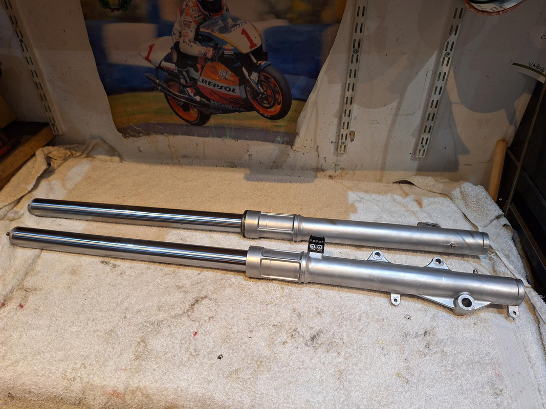

Finished the front forks with new lower bushes
The refinished pair. I'll get the Showa fork decals and Michelins on later.

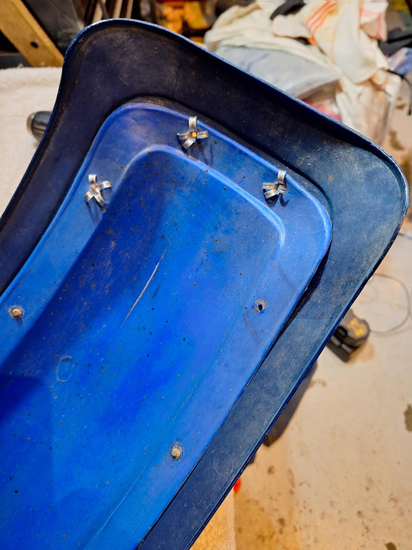

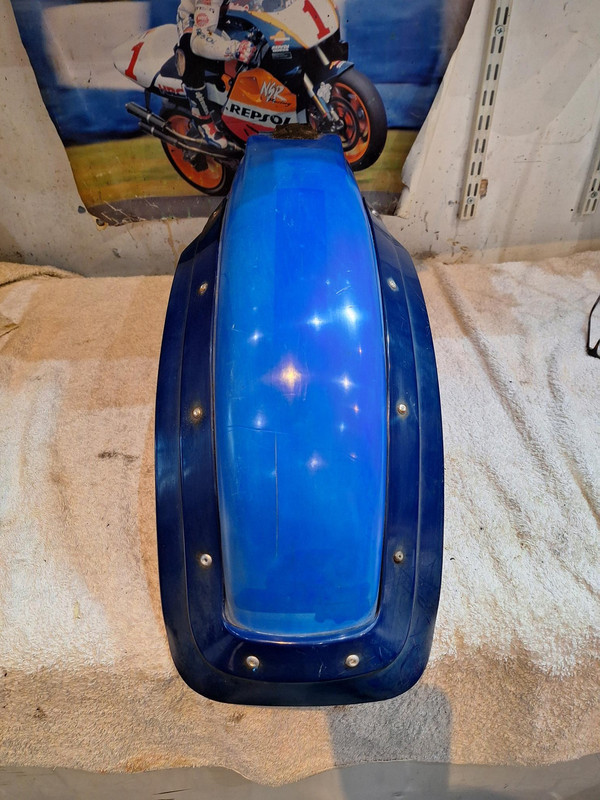

The front mudguard doesn't look too bad....
Until you look at the underside. I've drilled these out and will clean it and re-rivet.
