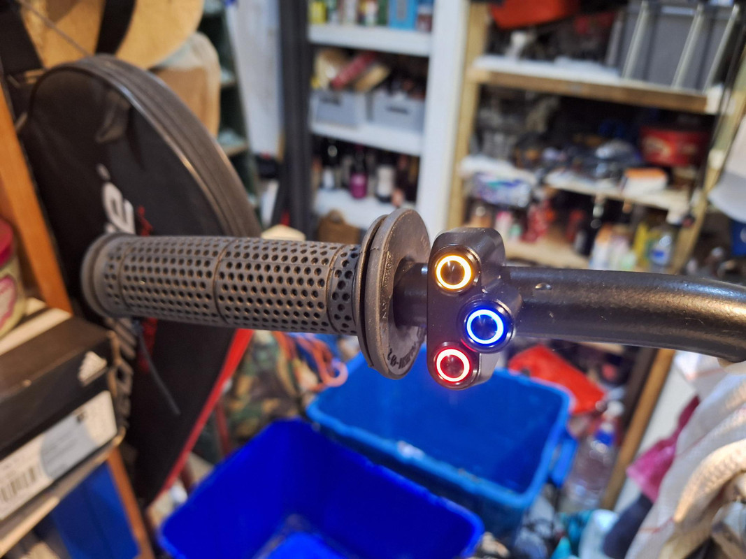

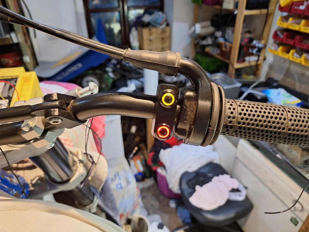

I wanted to update the electrics as the loom was nothing special and had been butchered in places, so I ditched it in favour of the Motogadget set up. I wanted a minimal MX look on the front end which made me go down the electrics through the bars route.
So after much messing about and drilling and threading wires here we have the result...
and on the other side.
I'm made up with it.
The colours are left side from top, yellow for indicator, blue for horn and red for lights.
On the right side from top, yellow for indicator, red for start.
The Motogadget is really intelligent and you can program the buttons to do different things for the duration of the push on the switch, for instance one tap switches the lights on, a double tap switches from dipped to main beam. You can also set at time for the indicators to turn off or just flash a preset number of times depending on button push.

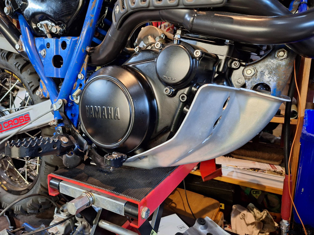

As I was in the garage today and had the sump guard vapour blasted a few weeks ago I thought it might as well go back on the bike.
I'm terrible for getting sub assemblies finished and then storing them somewhere safe, and forget what I've done with them :bigeek:
I bought another sump guard earlier this week, you can just make it out in the photo.
The plan is to try and make a passible replica of the Sonauto Dakar bikes guard :book:

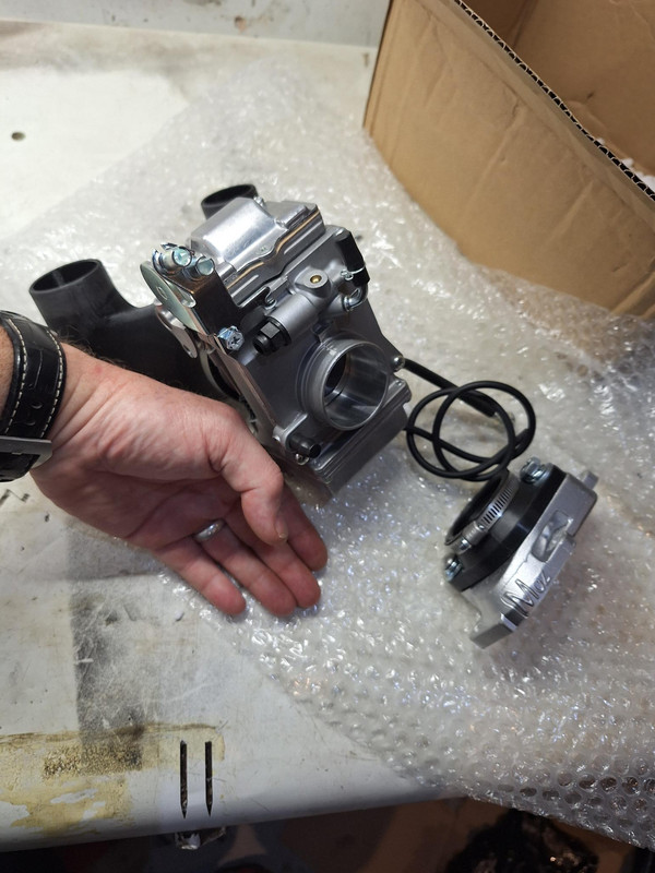

Here she is:
Absolute monster carb Mikuni 42mm.
Doesn't fit this bike as it has a 3TB motor in it and the cylinder head has a smaller diameter than the barrel so the one piece manifold doesn't sit right without me cutting back the cooling fins around the top of the rear part of the barrel.
However it can go on the second blue 1VJ.

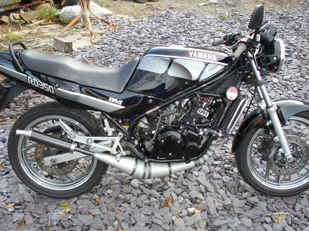

I love the factory colours used in a different way, almost like Yamaha had revisited it and updated the colour way and graphic style but keeping the traditions. I've done it on a few other bikes.
Here's one of my YPVS, not so bold but a start
