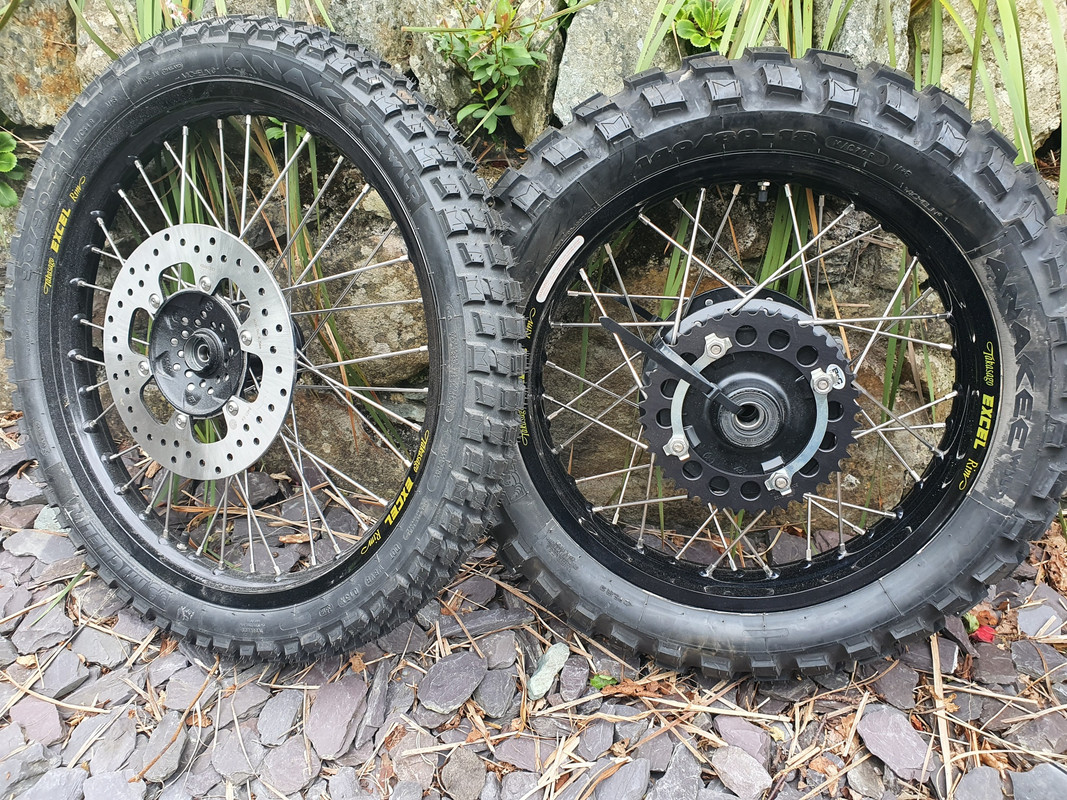

Wheels.
So I sourced some spare rough wheels for the black rim conversion.
These were stripped after noting the offset etc on the rims. The rear hub was drilled to accept the next up on spoke diameter, and the rear drum was machined to make it perfectly concentric.
Both hubs were blasted and powder coated. New bearings and seals, new brake shoes, new front disc, new sprocket retaining tabs, new Renthal rear sprocket which had to be anodised black after a mate said I hope you're not leaving it silver whip.
Stainless spokes and new black Excel rims were bought and my mate Doug built them for me, even fitting the new Michelin Anakee Wild tyres
They look even better in the flesh....
I'm not fitting these yet, she has a perfectly usable set of standard gold rims on her with some enduro tyres that I'll use to run her in on.

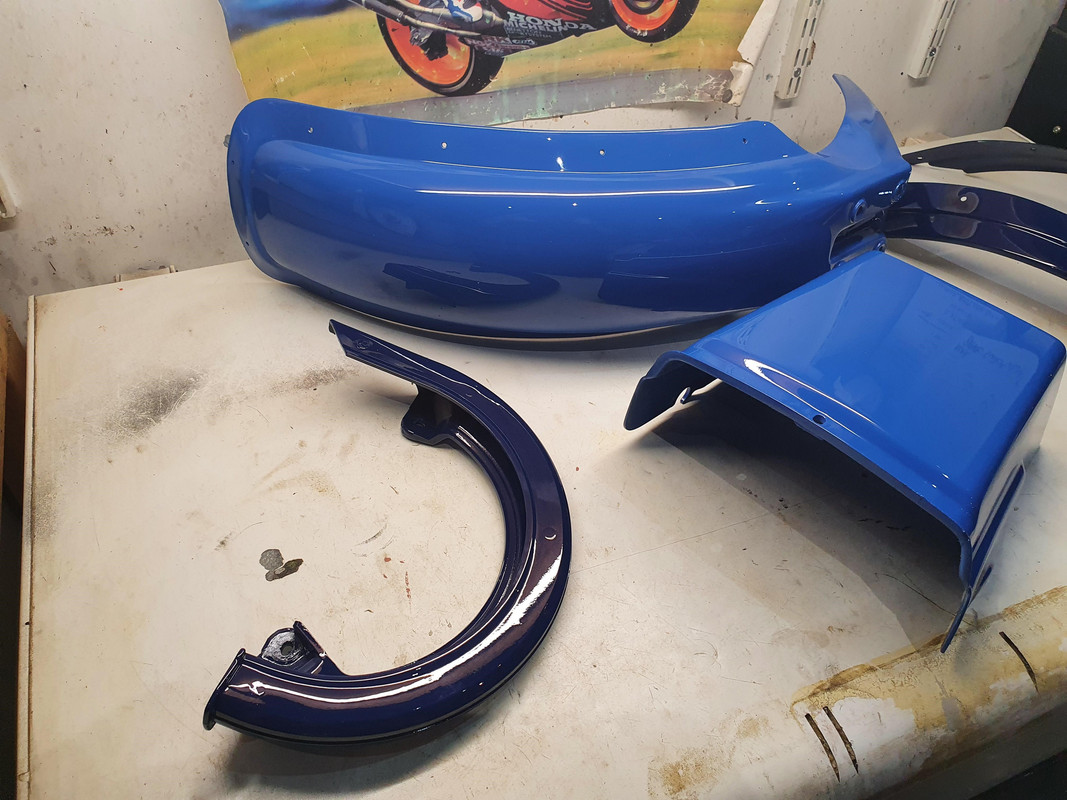

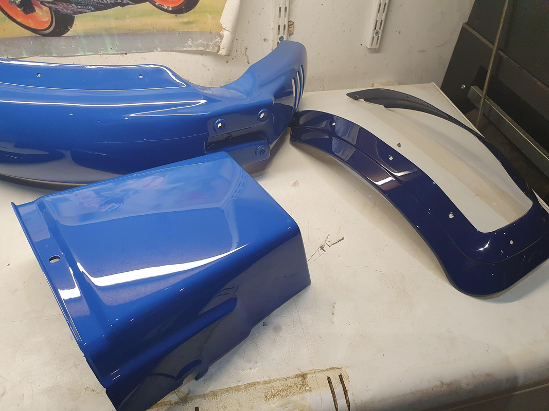

But, drum roll, I've got some of my bodywork back from the painters, and there's nothing better to focus the mind.
and another view of the same
I also have a TDR250 in the same Faraway Blue
Tank and side panels will be retrieved before the end of the week. The painters have had all the bodywork since Feb and I'd stripped the tank and rubbed the panels down. You can't rush a craftsman :bow:

Noice, im guessing you used some sort of flex agent in the paint or primer? or both? those early XT`s front guards flap away as i`m sure you know. And on the note,,,are you going to get one of them alloy mudgaurd braces? i think they look the part & also function.
