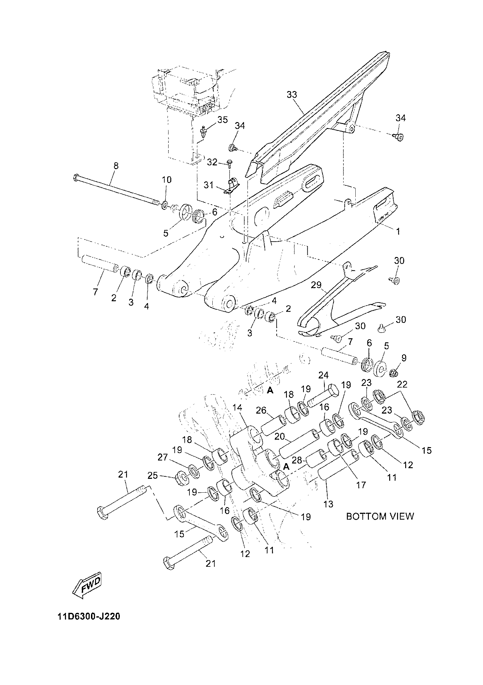

Re: Replacement swingarm pivot bushings NLA
Part No. 7 on this image:
