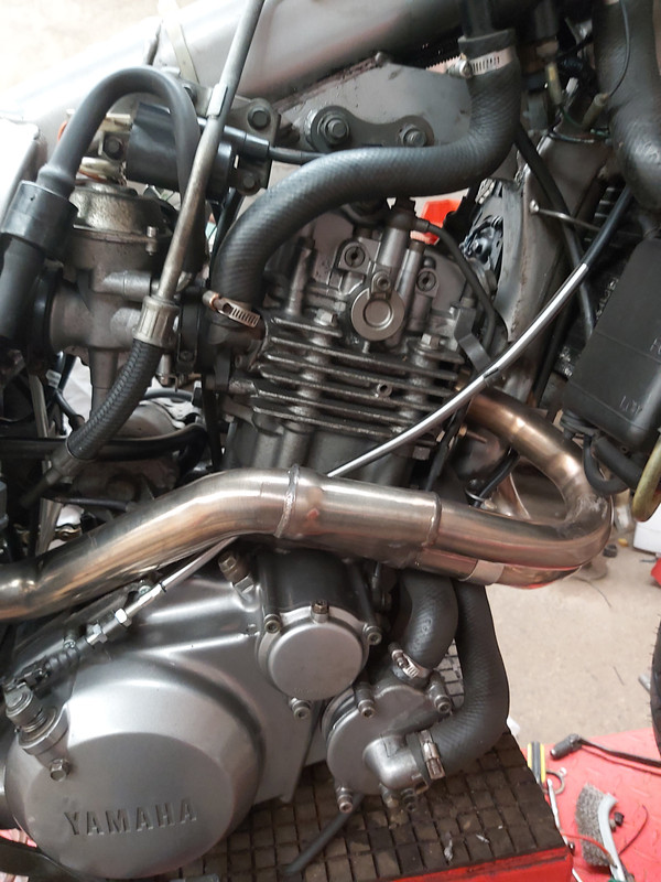

Just fitted some to my 4MY.... no rejecting required

Well GeoffD, that looks pukka.
I’m going to have to part with the cash now!
Any tips on fitting? New studs?, gaskets?
Thanks for posting , much appreciated.

I fitted new studs on the right hand side because they came out with the nuts, new gaskets are a must.
You might have to remove the clutch cable bracket and grind a bit off it, I had to as it was just catching the exhaust... I also put a couple of small spacers behind the bracket for a bit of extra clearance.. if you look at the adjusters on the bottom of the cable you can see what I mean

I’ve committed to the big bore headers now.
Thanks for the invaluable info GeoffD. (Nice clean engine btw)
