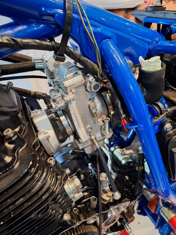

I ordered a single carb conversion kit, nearly a year ago from MikuniOz.
Now fitted, it's an extremely tight fit but it doesn't touch.
There's a way to fit it, Y piece in first, attach the rubber mount to the carb and then slide the carb onto the new alloy inlet manifold, and tighten up.
If you haven't pre mounted the bolts in the mounting rubber it all has to come apart again.
As you can probably tell I had a few goes at this :bigeek:
Anyway, it really looks the part:
From the left side.
And from the right side.

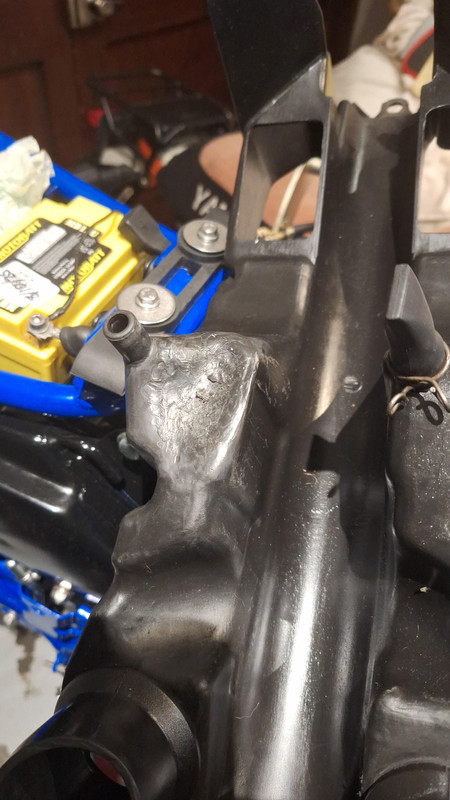

What I hadn't envisaged was the amount of work on the airbox firstly to get it to sit right and not rest on the carb actuator pulley and secondly to make a respectable job of joining the 3D printed Y piece from the rear of the carb, which came in the kit, to the original air tubes at the back of the airbox, photos to follow...

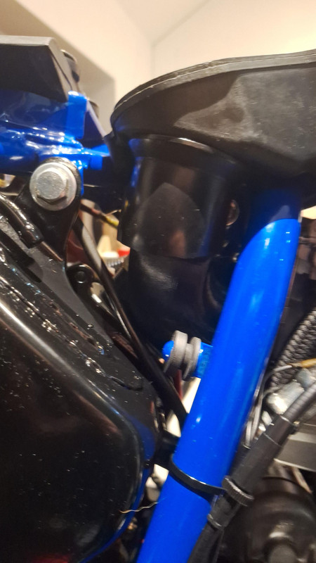

Airbox pipes from right hand side.
Looking down on to the right hand side 3D printed new Y piece. Don't worry the top shock bolt is now correctly torqued.
Modified underside of the original 1VJ airbox to get clearance for the throttle actuator pulley. Done with a powerful heat gun and lots of patience, I'm quite pleased with how it turned out.

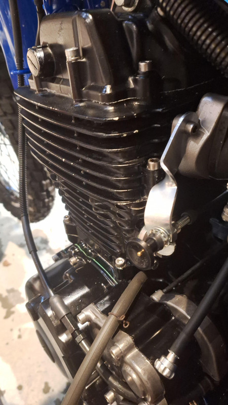

Looking from the left hand side at the new choke and bracket supplied in the kit.

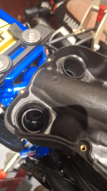

Here's a photo showing the view down from the original air tubes to the new Y piece.
There's easily 50mm of overlap and I've used clear silicon on the joints.
