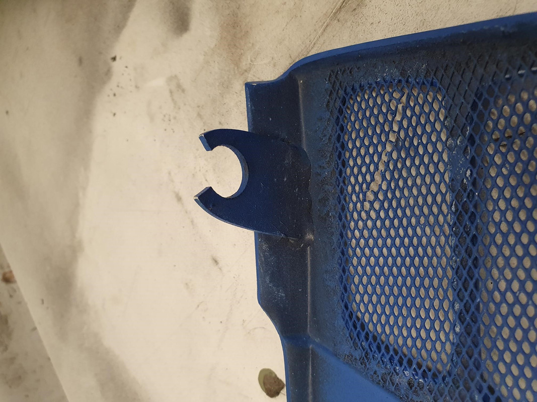

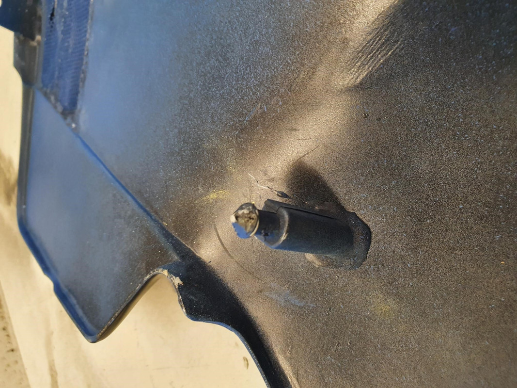

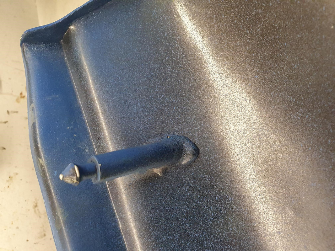

Nothing snapped off yet.
I had to open the forward mounting lugs up a bit so they weren't getting stressed, and make the rear mounts more conical in shape.

Here you go, JRE side panel inner mounts:
I had to open out the front mount as the gap was too small.
The white you can see on the cone shape mounts is where I've taken off excess plastic to make them fit nicely.
You can clearly see on all mounts where they have been glued or bonded to the side panel.
In my case I use these panels so I don't have to worry about the genuine Yamaha panels getting damaged.

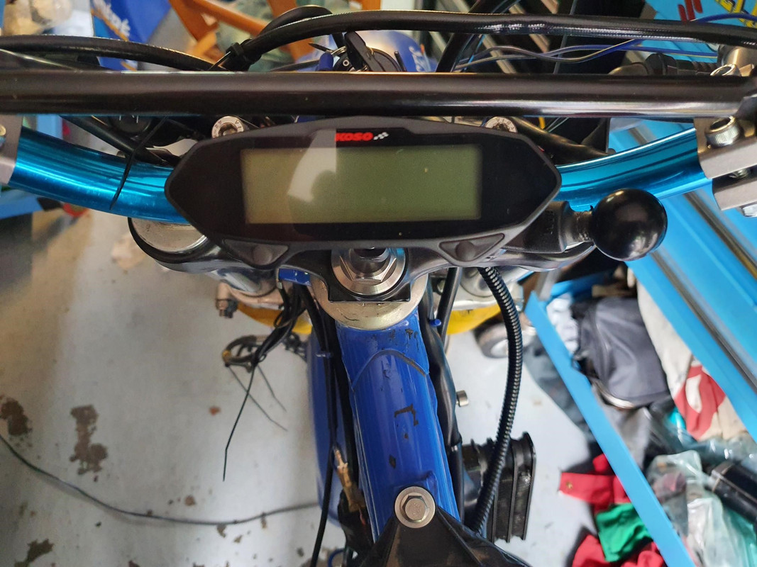

A little bit more done over the weekend.
Started fitting the Koso dash, it has lots of advantages for a bike that's going to be used, easy conversion between KMPH and MPH, oil change, temp and level, well protected, cheap and easily replaceable. I went the same as I've fitted to the white 1VJ.

We did about 100 miles on it messing about, I'd like to move the Koso dash higher up to make it easier to see. But I'm hankering after a Trail Tech Voyager Pro dash which has GPS and off road maps, it would also fill the void I made by removing the old clocks very nicely.
